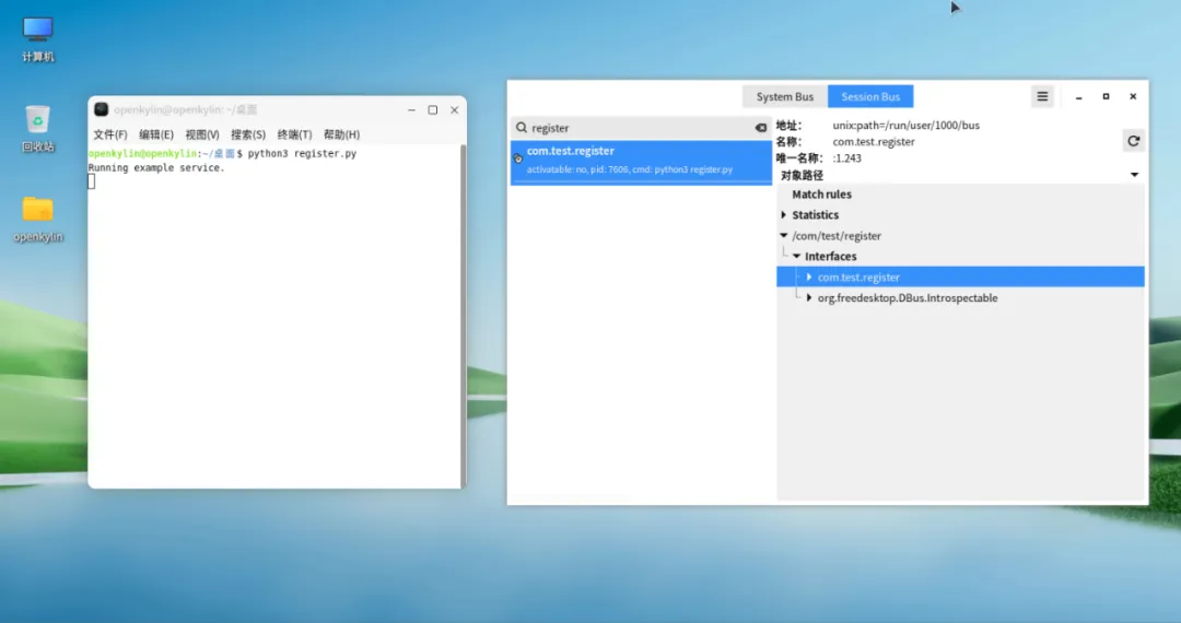

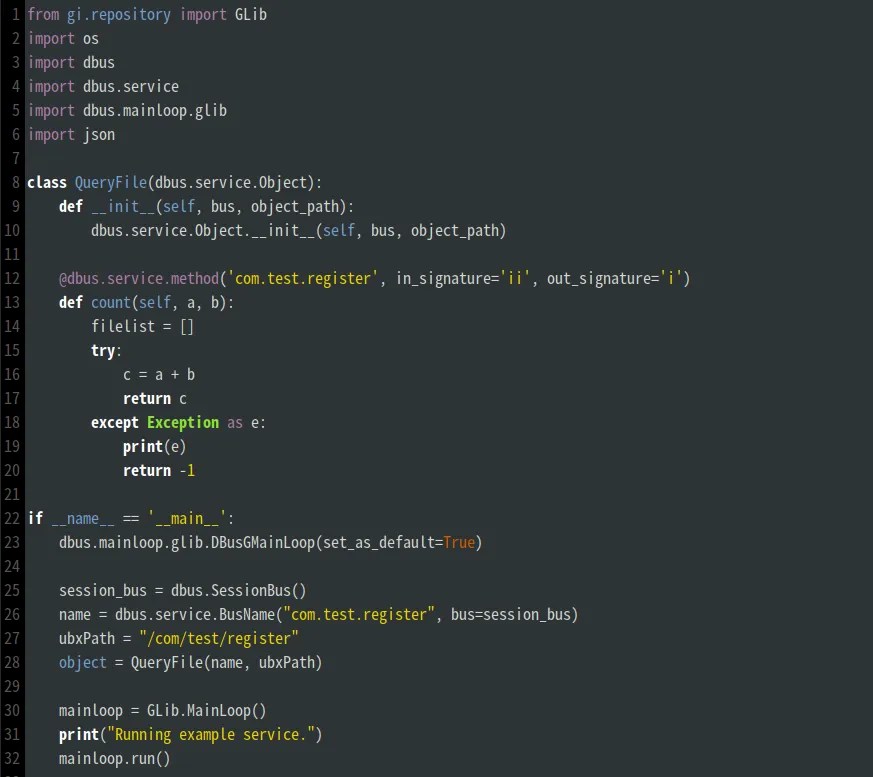

SessionBus is used for communication between desktop user applications. Below, we use the Python script shown in Figure 2 as an example. By executing ‘python3 register.py’ in the terminal, a SessionBus for calculating the sum of two numbers will be created.
openKylin
Figure 2 Register Script
Once the script is executed, search for register in the SessionBus input. As shown in Figure 3, you should see the SessionBus named come.test.register.
openKylin
Figure 3 D-Bus Search

Once the preparations are complete, you can proceed with coding in Golang. As shown in Figure 4, run the command ‘go run -o invokedbus invokedbus.go’ in the Golang environment to generate a binary file named invokedbus.
By comparing the code with the created D-Bus information, you can see that the program's “com.test.register” is the name of the created D-Bus, which is also the path that the Golang code needs to call at runtime. By appending the count method to this path, the D-Bus call can be executed.
openKylin
Figure 4 Golang Program

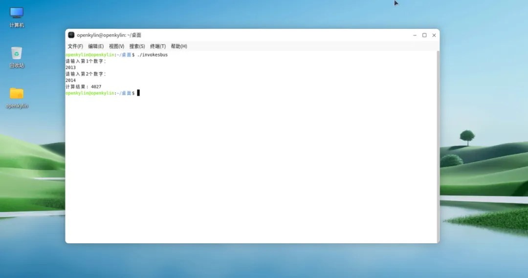

After generating the binary file invokedbus, execute it using the command ‘bash ./invokedbus’. You will see the interface shown in Figure 5. Follow the prompt to input the first and second numbers, and the program will output the final result of the calculation.
openKylin
Figure 5
